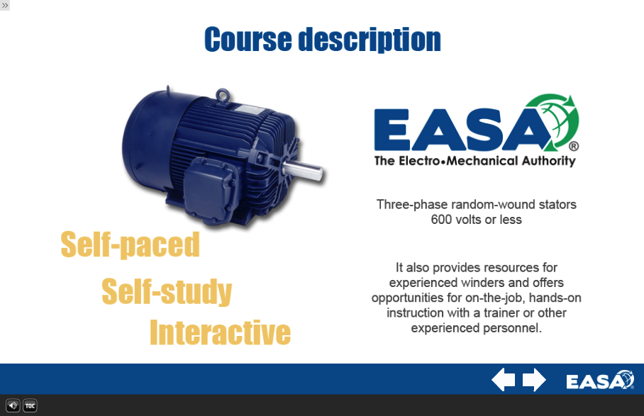

Self-paced, interactive training for stators 600 volts or less
This valuable interactive training tool is ideal for training your novice(s). Even experienced winders will learn from it. This online course teaches how to wind in a richly detailed, step-by-step approach. This course includes narrative, animations and video clips, with tests to assess student comprehension.
This course is only offered through EASA's Learning Center.* Subscription required. LEARN MORE
VIEW A DEMO
Overview Of The Course The course is primarily intended for new winders with little or no winding experience. It can also be used for reinforcement and expansion of more experienced winders knowledge of random winding. Further, many of the techniques and principles used for three phase random windings can also be applied to armatures, wound rotors, field coils, and form coil stator windings.
The software is interactive, and self-paced. You can repeat each section as many times as you like, until you are comfortable with the material. By practicing the techniques you will learn from the video segments, you will be able to learn to rewind motors more quickly than by using only the traditional “on-the-job training”.
The lessons generally progress in the same order as the winding work, though there are some exceptions, and include narrative, animations and video clips, and tests to assess student comprehension. Other features include "Pro Tips" and "Drill Downs" which are designed to enhance the learning experience.

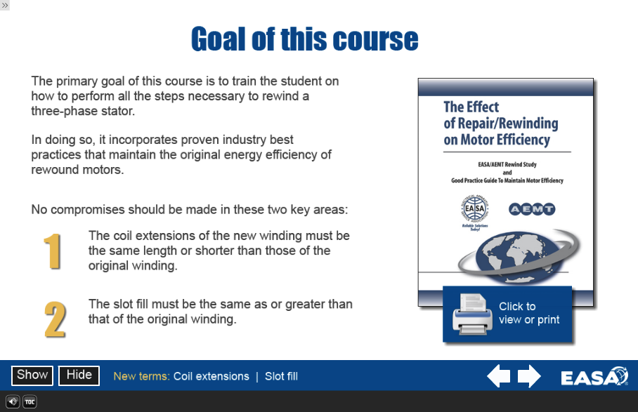

Objectives Of The Course The primary objectives of this interactive course are to provide the student with necessary information on the methods, materials and tools to properly rewind a three-phase, random wound stator. Further, to teach the student (i.e., the novice winder) the correct steps and procedures to effectively apply this information in the rewinding process. The ultimate objectives are for the student to become an accomplished winder.

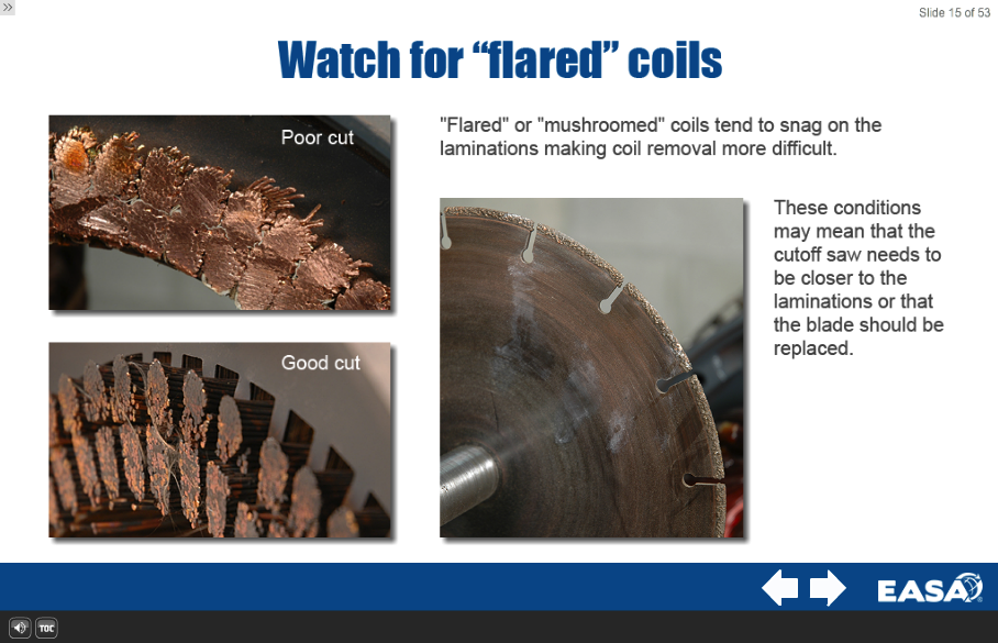

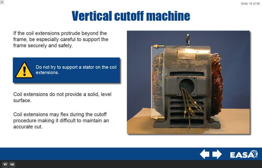

Lesson 3: Coil Cutoff The critical objective of the Coil Cutoff lesson is to be able to cut off coil extensions without injury to the technician or the stator. Essentially the idea is to cut the copper wire, not any other metal part of the stator, and to do it in a manner that does not harm the stator or the person performing the task. Proper cutting of the coil extensions also reduces time and effort when pulling the coils out.

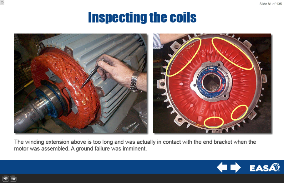

Lesson 6: Core Preparation After removal of the windings and insulation, the bare core must be made ready for winding insertion. Key objectives in Core Preparation are how to clean, inspect and prepare the bare core; and how to repair lamination damage and defects. This step assures that the core is in satisfactory condition prior to actual rewinding, and is associated with the Core Testing lesson. The prepared core is core tested to verify that core losses have not increased from the initial core test by an unacceptable amount. The repeated core test reinforces the aspects of the core test for the student, and provides a learning opportunity for the student to calculate the before versus after parameter comparisons.

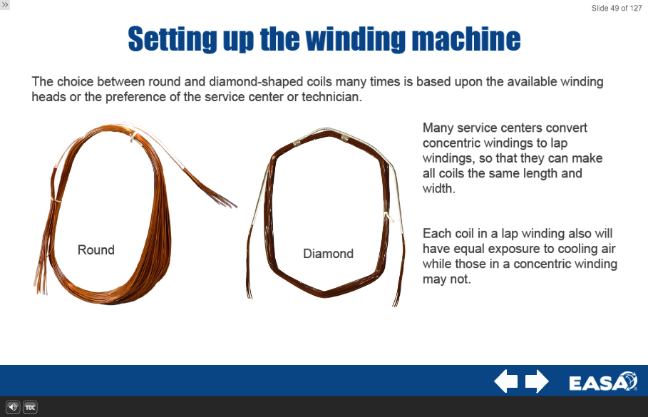

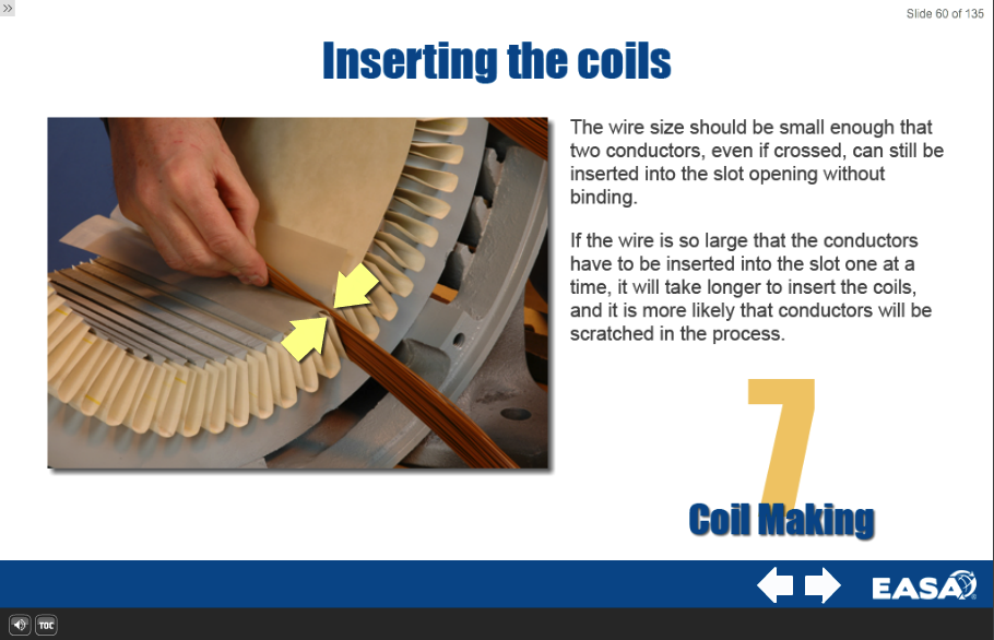

Lesson 7: Coil Making All of the steps and associated lessons to this point have dealt with existing windings and stator components. The first step in actual rewinding is Coil Making; that is, creating new coils from new magnet wire and other materials. The primary objectives of Coil Making are recognizing the materials, tools and equipment needed; and how to make random wound coils to be installed into a three-phase stator core. The student will learn that the new coils must have equivalent turns and wire area as the original winding, and have the same physical features such as coil extensions. Coil making equipment varies considerably; therefore the mentor should provide the student with specific instructions on the use of the coil winding equipment in their service center.
Lesson 8: Winding Insulation and Coil Insertion Having made new coils, they need to be inserted into the core, bringing up the next step, Winding Insulation and Coil Insertion. The objectives of this lesson are to be able to determine the materials and tools needed; and how to install random-wound coils into a three-phase stator core. There are actually multiple steps in this process, dealing with insulating and inserting. The slots are insulated, then coils inserted, followed by insulating between coils. The student will also learn how to recognize a properly inserted set of coils.

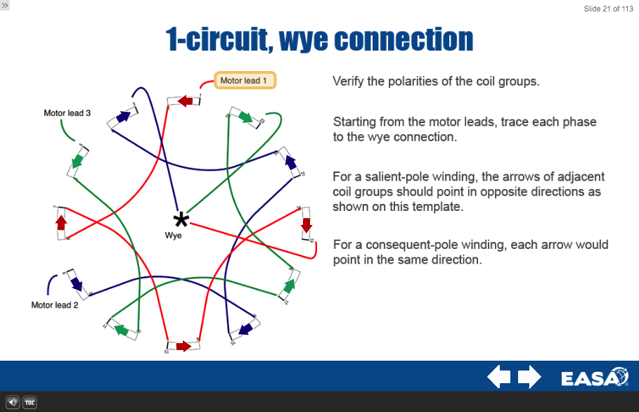

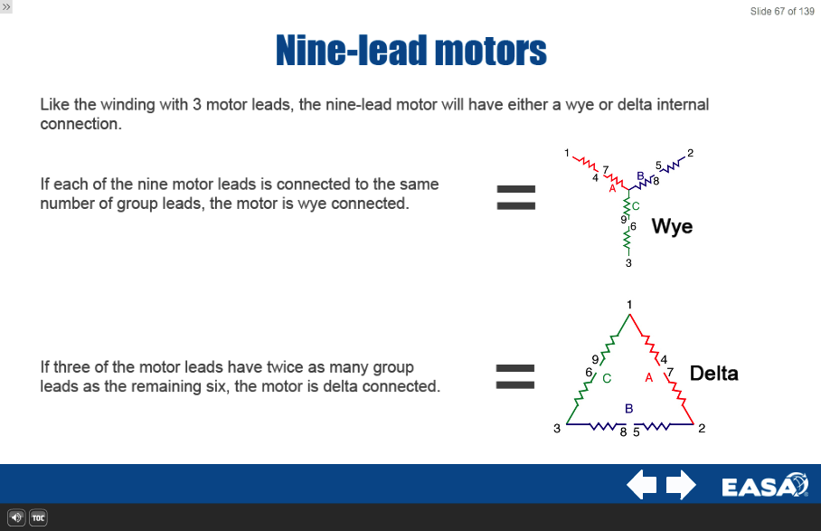

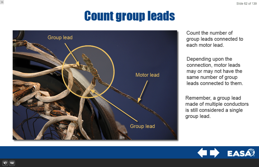

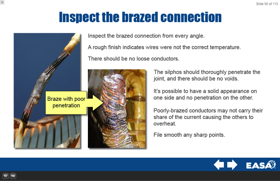

Lesson 9: Internal Connections Even though the winding coils have been made and inserted correctly, the winding will not perform properly if it is not connected correctly. This is accomplished in the next step, Internal Connections. In addition to requiring physical accuracy and attention to detail, the student will learn the steps necessary to “lay out” and verify the accuracy of the connection. Critical objectives of this lesson are how to identify and lay out winding connections, and the procedures for actually connecting the winding. The student will also gain an appreciation for the unlimited variety of possible winding connections and layouts.

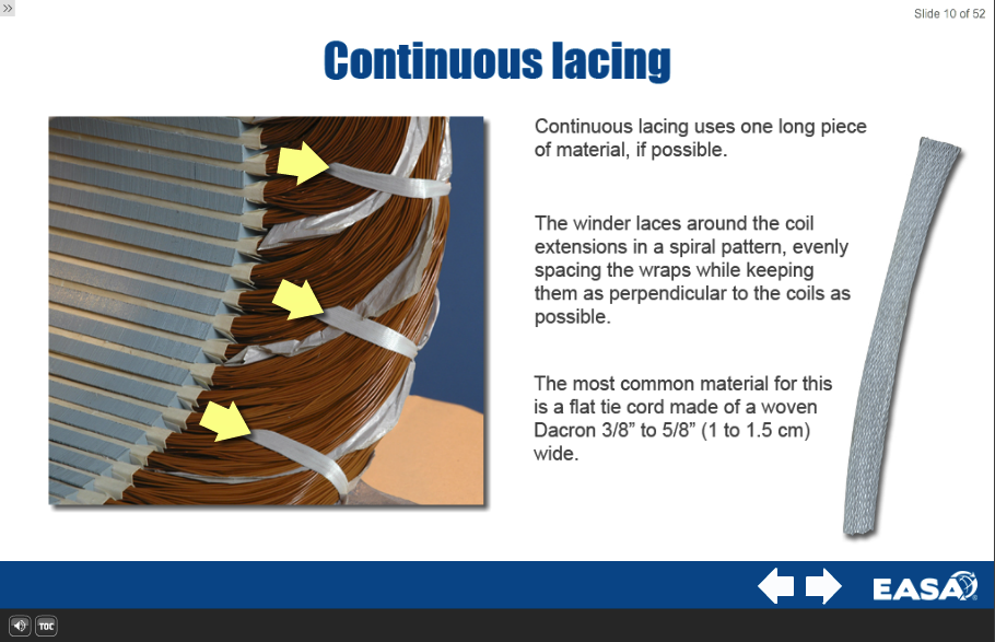

Lesson 10: Lacing and Bracing of Windings The inserted winding coils should be snug in the slots, but will need reinforcement to reduce the tendency to move or shift. Varnish treatment and curing will do much to make the winding more rigid; however, there is another key step to be used to reinforce winding coils. That is Lacing and Bracing of Windings, with the main objectives being to make the winder proficient in the methods, materials and procedures for lacing and bracing of windings. The student will also learn how to determine the amount and type of bracing to use on different windings.

Summary To summarize, it is worth restating the first paragraphs on the course objectives. The primary objectives of this interactive course are to provide the student with necessary information on the methods, materials and tools to properly rewind a three-phase random wound stator. Further, to teach the student (i.e., the novice winder) the correct steps and procedures to effectively apply this information in the rewinding process. The ultimate objectives are for the student to become an accomplished winder, able to rewind all the different types of windings seen in the service center (e.g., random wound stators, form coil stators, random and form wound rotors, random and form armatures, and field coils).

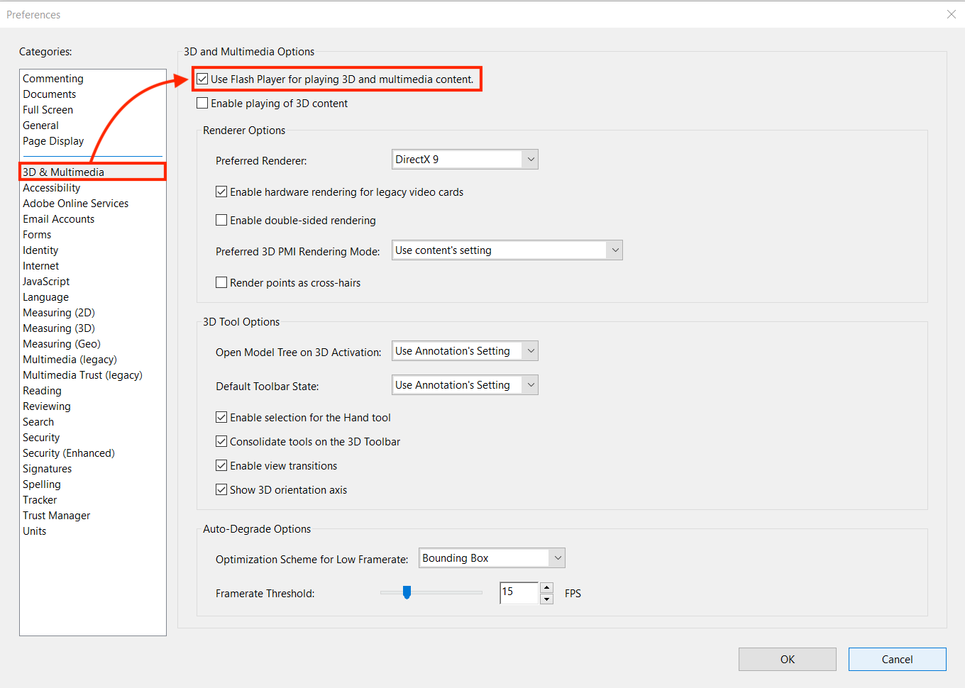

Troubleshooting issues with Adobe Flash Player This software requires the NPAPI version of Abode Flash in order to run properly within Adobe Reader. To download the proper version of Adobe Flash, go to https://get.adobe.com/flashplayer/otherversions. In Step 1, select your operating system, then in Step 2 select the "NPAPI" version of Flash. After the download completes, install Adobe Flash.
Note: To see what version of Adobe Flash is installed in Windows 10, go to Windows (icon) > Settings > Apps. Scroll through the list of apps until you find “Adobe Flash Player.” If you see NPAPI in the app description, you have the correct version of Flash installed. If not, follow the instructions above to download the NPAPI version.

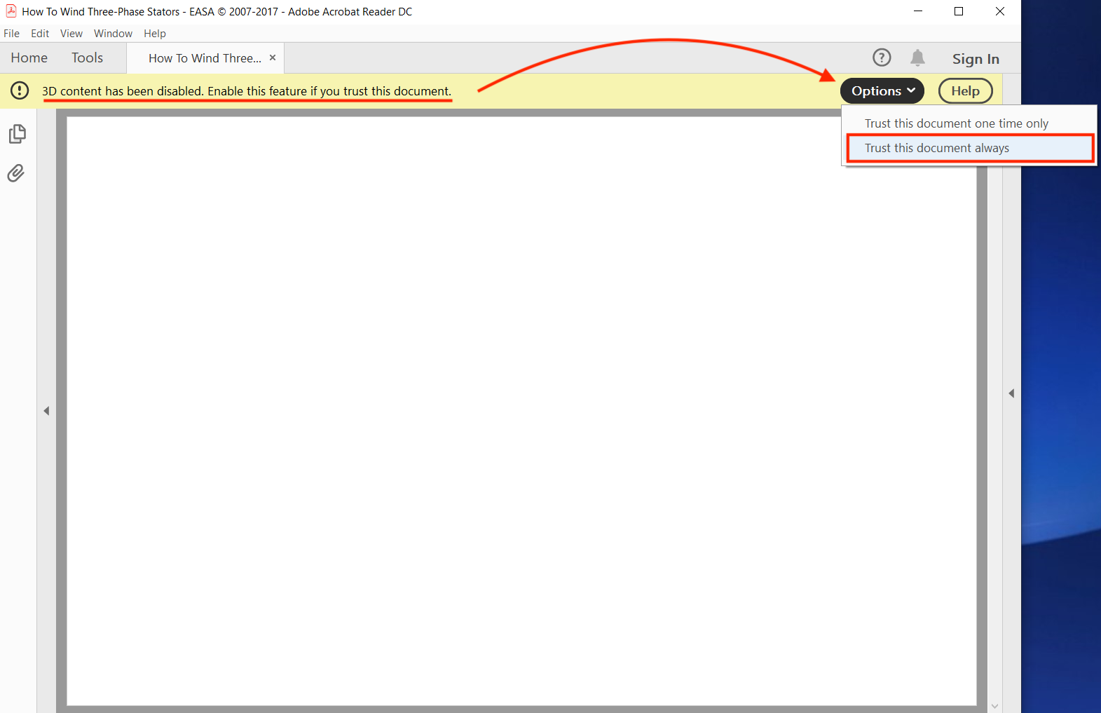

Newer versions of Adobe Reader now have Adobe Flash multimedia playback disabled by default. Follow these steps to enable Adobe Flash.

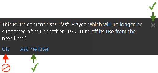

Additionally, you may be shown the popup below. If you see this popup, DO NOT CLICK "Ok" as this will disable Adobe Flash Player the next time this PDF is opened. Instead, click the "X" or "Ask me later". If "Ok" is clicked, repeat steps 1 - 4 above to re-enable Adobe Flash.
