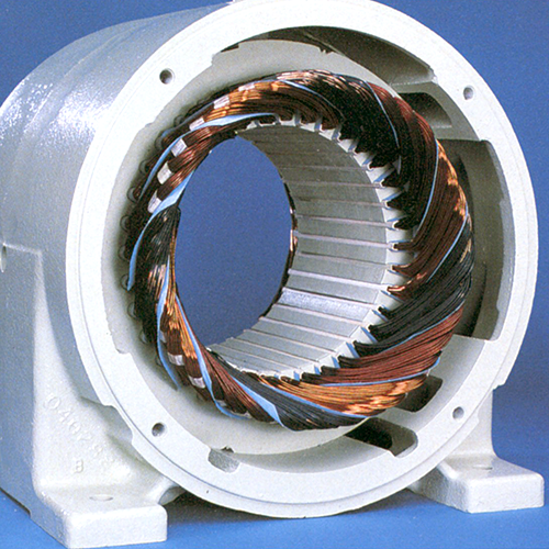

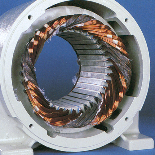

The life of a three-phase stator winding can be shortened dramatically when the motor is exposed to unfavorable operating conditions — electrical, mechanical or environmental. The winding failures illustrated here are typical of what can happen is such circumstances. Failures are shown here to help identify the causes of failure, so that, where possible, preventative measures may be taken.

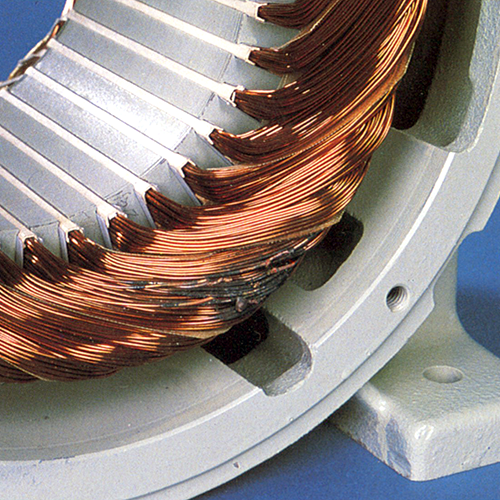

Winding single-phased (wye-connected)
Winding single-phased (wye connected)
A single-phased winding failure is the result of an open in one phase of the power supply to the motor. The open is usually caused by a blown fuse, an open contactor, a broken power line or bad connections.

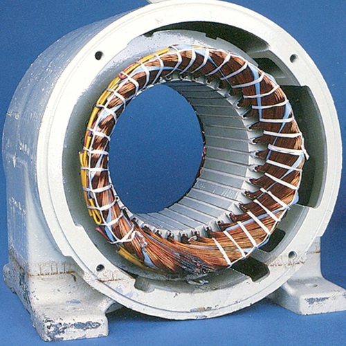

Winding single-phased (delta-connected)

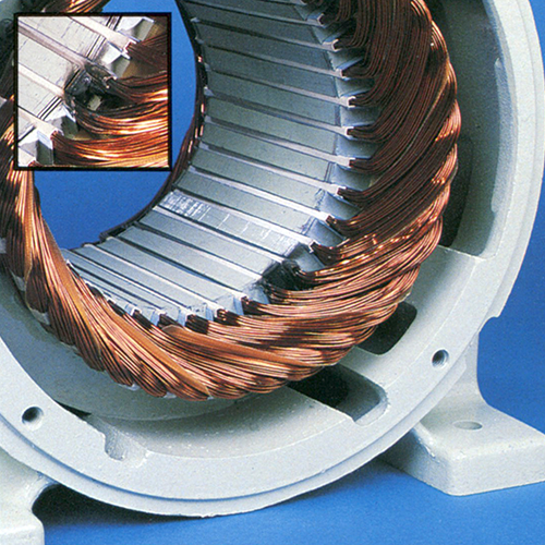

Winding shorted phase-to-phase
This type of insulation failure is typically caused by contaminants, abrasion, vibration or voltage surge.

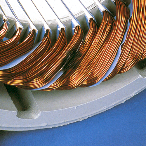

Winding shorted turn-to-turn

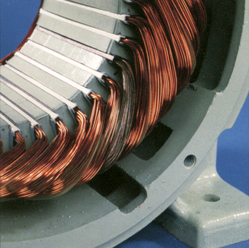

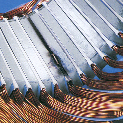

Winding grounded at edge of slot

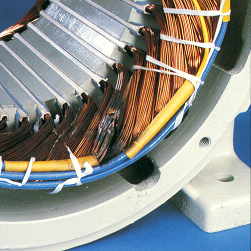

Phase damage due to unbalanced voltage
Thermal deterioration of insulation in one phase of the stator winding can result from unequal voltage between phases. Unequal voltages usually are caused by unbalanced loads on the power source, a poor connection at the motor terminal, or a high resistance contact (weak spring). Note: A one-percent voltage unbalance may result in a six- to ten-percent current unbalance.

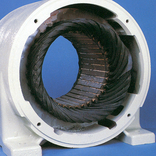

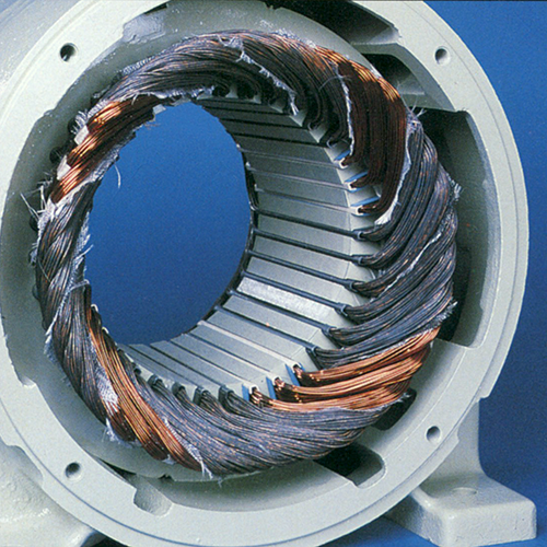

Winding damaged due to overload
Thermal deterioration of the insulation in all phases of the stator winding typically is caused by load demands exceeding the rating of the motor. Note: Under-voltage and over-voltage (exceeding NEMA standards) will result in the same type of insulation deterioration.

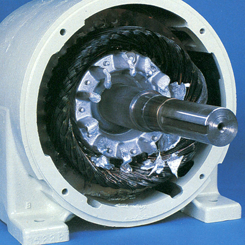

Damage caused by locked rotor
Severe thermal deterioration of the insulation in all phases of the motor normally is caused by very high currents in the stator winding due to a locked rotor condition. It may also occur as a result of excessive starts or reversals.
