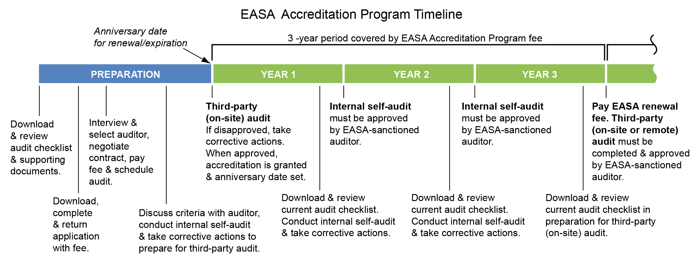

The EASA Accreditation Program runs in a three-year cycle made up of a third-party audit, followed by two internal self-audits that are submitted to your auditor for approval. To maintain accreditation, the service center must successfully perform these audits.
At the end of the third year, the cycle begins again with the payment of the non-refundable EASA renewal fee ($300 for EASA members, $1500 for non-members) and the successful completion of a third-party (on-site or remote*) audit.
All audits must be completed, approved and submitted to EASA no more than 60 days after the anniversary date of your original audit approval. Additionally, renewal audits must not be performed more than 60 days prior to your company's anniversary date.

Click to enlarge timeline
